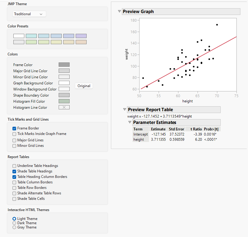

The Styles page lets you customize colors, tick marks, grid lines, and report tables.
For more information about configuring the appearance of graphs, see Preferences for Data Tables.
Figure 15.4 Styles Preferences
Styles Preferences

JMP Theme
Allows switching between four themes and change the appearance of JMP.
Traditional
The current default appearance of JMP.
Comfortable
Enhanced spacing for margins and padding of visual elements.
JMP Live
Aligned with the visual style of JMP Live.
JMP Clinical
Aligned with the visual style of JMP Clinical.
Color Presets
Provides a set of predefined colors for use in customizing the appearance of reports, graphs, charts, and so on. Tints of the selected color are applied to the various elements.
Note: The selected color is applied to windows also.
Frame Color
Defines the color that is applied to a graph frame and tick marks. Click to change the default color.
Major Grid Line Color
Defines the major grid line color. Click to change the default color.
Minor Grid Line Color
Defines the minor grid line color. Click to change the default color.
Graph Background Color
Click the color box to select a background color for all graphs. Click to change the default color.
Window Background Color
Click the color box to select a background color for all reports and data tables. Click to change the default color.
Shape Boundary Color
Click the color box to select the color for shape files boundaries.
Histogram Fill Color
Defines the color to fill the histogram. Click to change the default color.
Histogram Line Color
Defines the histogram line color. Click to change the default color.
Original
Click to restore default color settings.
Frame Border
Shows borders only on the axes. This option is selected by default.
Tick Marks Inside Graph Frame
Shows axis tick marks inside the graph frame. This option is deselected by default.
Major Grid Lines
Shows major grid lines on graphs. This option is deselected by default.
Minor Grid Lines
Shows minor grid lines on graphs. This option is deselected by default.
Underline Table Headings
Shows a border under table headers. This option is deselected by default.
Shade Table Headings
Shows table headers with shading. This option is selected by default.
Table Heading Column Borders
Shows divider lines between columns in table headers. This option is selected by default.
Table Column Borders
Shows borders between table columns. This option is deselected by default.
Table Row Borders
Shows borders between table rows. This option is deselected by default.
Shade Alternate Table Rows
Shows alternate table rows with shading. This option is deselected by default.
Shade Table Cells
Shows table cells with shading. This option is deselected by default.
Interactive HTML Themes
Specifies the color theme for interactive HTML pages. The default theme is Light Theme.
