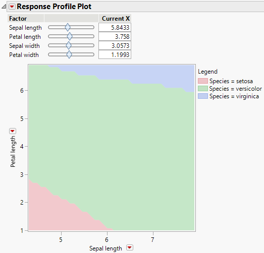

If you have a categorical response, you can visualize the model classification in the Response Profile Plot. The SVM platform also provides misclassification rates, confusion matrices, and ROC and Lift curves to help you determine how well your model fits the data. If you have a continuous response, fit statistics and actual by predicted plots are used to determine how well the model fits the data.
Figure 9.1 Response Profile PlotĀ
