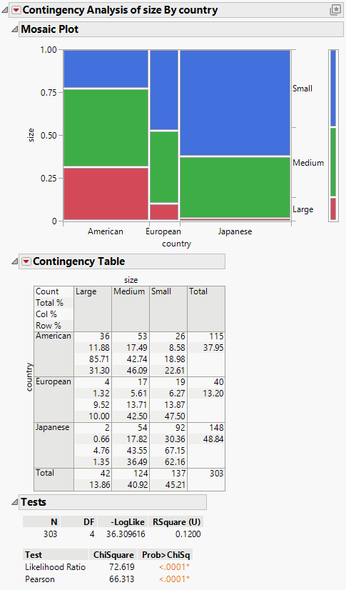

The Contingency report initially contains a mosaic plot, a contingency table, and tests to determine whether the levels of the Y response variable differ across the levels of the X factor variables. You can run additional analyses and tests using the red triangle menu options. See Contingency Platform Options.
This section contains information about the following sections of the Contingency report:
Mosaic Plot
Contingency Table
Tests Report
Figure 7.4 Example of a Contingency Report
