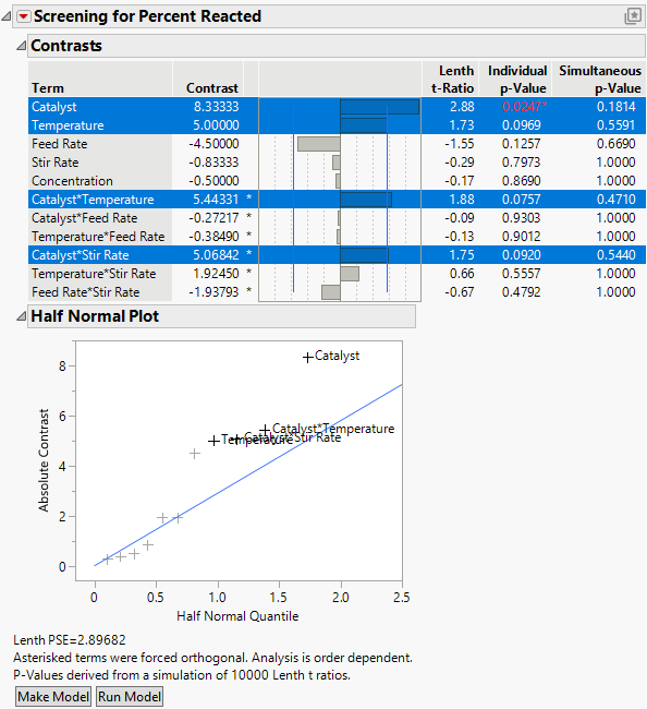

The Fit Two Level Screening Report
The Screening report shows a summary table of the design contrasts (candidate model terms) and a half normal plot. You can launch or run the selected model from the report.
Figure 11.5 Screening Report
Screening Report
The Screening Report contains the following sections:
Contrasts
Half Normal Plot
Make or Run Model
