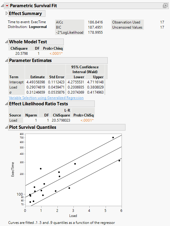

Plot Survival Quantiles
Shows the data points plotted with the 0.1, 0.5, and 0.9 quantiles.
Figure 6.5 The Parametric Survival Fit Report
