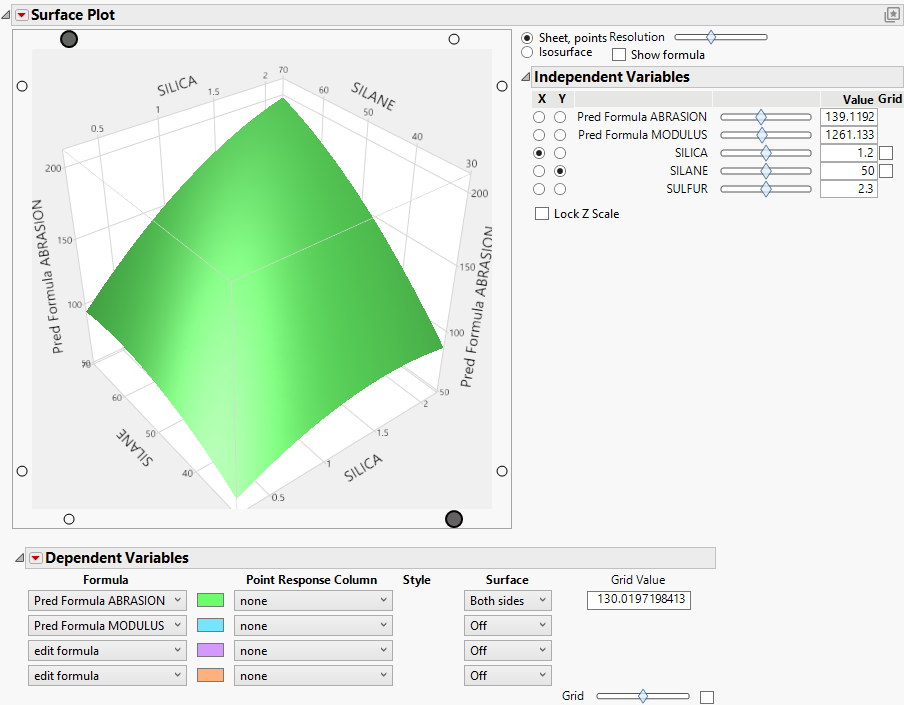

The initial Surface Plot report shows the surface plot, the appearance controls, the Independent Variables controls, and the Dependent Variables controls. If more than one prediction formula column is specified, only the first surface is displayed in the initial report. However, if more than one observed response column is specified, all points are displayed in the initial report.
Figure 5.6 Example of the Surface Plot ReportĀ
