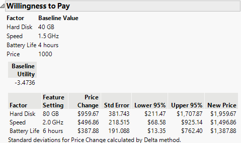

Willingness to Pay Report
The Willingness to Pay report displays the baseline value for each factor and baseline utility values. For each factor, the report shows the feature setting, estimated price change, and new price. If there are no interaction or second-order effects, standard errors and confidence intervals are also shown. These are calculated using the delta method.
Figure 4.21 Willingness to Pay Report
