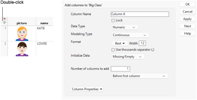

Double-click the upper triangular area in the data grid above the row numbers. The New Column window appears.

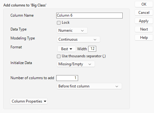

To add one or more columns by using New Columns
1. (Optional) Select the column before or after which the new column or columns are to be added.
2. Select Cols > New Columns.
3. Change the column name.
By default, the new column names are Column 1, Column 2, and so on.
4. Select the data type, modeling type, and format for all of the columns.
See “About the Column Info Window”.
5. (Optional) Select initial data values for all of the columns.
See “Initialize Data in a Column”.
6. Specify where you want to put the new columns.
If you do not select an option, the column is added after the last column.
7. (Optional) For multiple columns, specify whether the columns should be grouped.
See Group Columns in Data Tables.
8. To add more columns, follow these steps:
a. Click Apply to add the new column.
b. Click Next, change the column properties, and then click Apply.
c. Click Next to add another column.
9. Click OK to save your changes.
1. Double-click the upper triangular area in the data grid above the row numbers.
Figure 4.3 Adding Multiple Columns
2. Change the prefix for each column.
3. Enter the number of columns to add.
4. Select the data type for all of the columns.
5. Specify where you want to put the new columns.
6. Click OK to save your changes.
