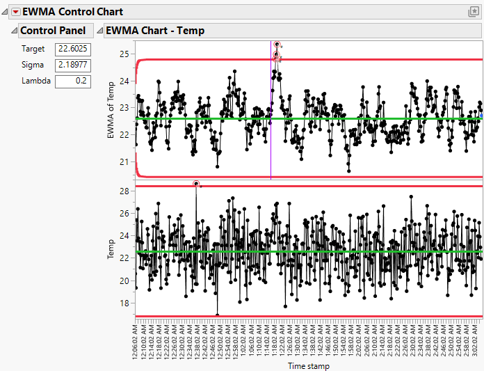

6. Click the EWMA Control Chart red triangle and select Test Beyond Limits.
Figure 11.7 EWMA Chart with Points Beyond Limits Highlighted
Note that three observations are outside the limits in the EWMA chart and one observation is outside the limits in the X chart. The observations outside of the limits are indicated by a red circle. The purple vertical line in the EWMA chart denotes a shift upward around 1:16 AM.

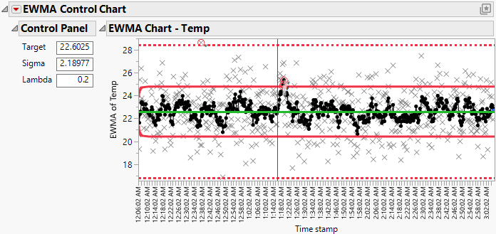

7. Click the EWMA Control Chart red triangle and select Overlay Charts.
The X chart limits are not shown on the overlay chart by default, so the observation outside the X limits is not circled until you turn on the X limits for the overlay chart.
8. Click the EWMA Control Chart red triangle and select Show X Limits on Overlay Charts.
Figure 11.8 EWMA Chart with Overlaid X Chart
The solid lines and circles in the top chart represent the limits and points for the EWMA chart. The dashed lines and x markers represent the limits and points for the X chart. Note that the observations outside the EWMA limits and the X limits are still circled.

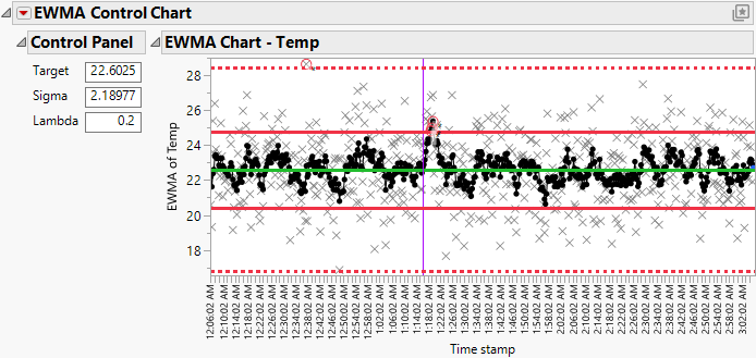

9. Click the EWMA Control Chart red triangle and select Constant Limits.
Figure 11.9 EWMA Chart with Constant Limits
Because the time span of the data is so long, the asymptotic limits differ from the original EWMA limits only for the first few subgroups. In this case, you might decide that you can use constant (asymptotic) limits instead of the EWMA limits.
