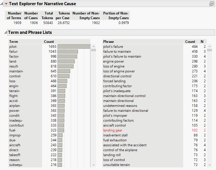

Figure 12.14 Text Explorer Report for Narrative Cause
From the report, you see that there are almost 51,000 tokens and about 1,900 unique terms.
10. Right-click pilot· in the term list and select Select Rows.
From the number of selected rows in the data table, you see that some form of the word “pilot” occurs in more than 1,300 of the incident reports.
11. Right-click pilot· and select Add Stop Word.
Because some form of the word “pilot” occurs frequently compared to other terms, these terms do not provide much information to differentiate among documents. All of the terms that stem to pilot· are added to the stop word list.

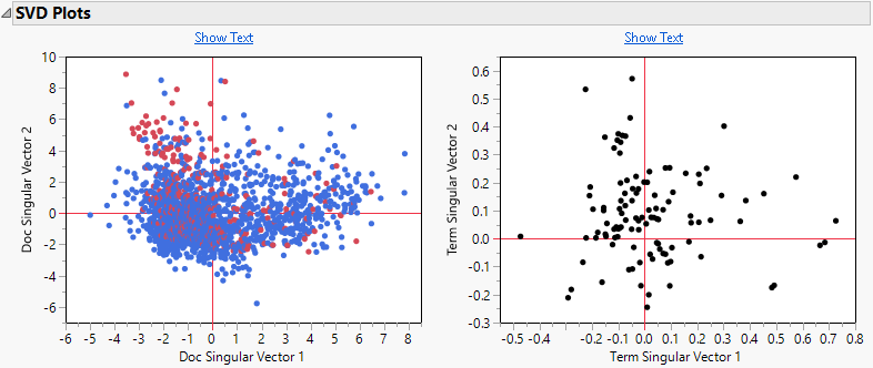

Figure 12.15 SVD Plots for Narrative Cause
There is not a lot of difference in the document SVD plot between fatal and nonfatal incidents.

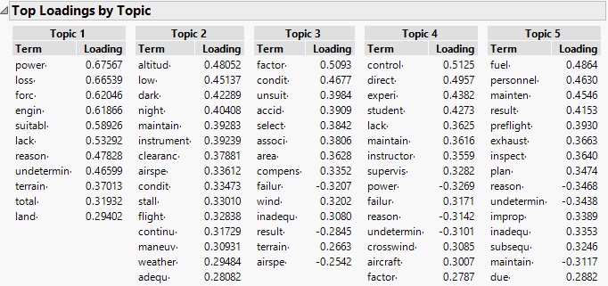

Figure 12.16 Top Loadings by Topics for Narrative Cause
The terms for each topic with the highest loadings enable you to interpret whether the topic is capturing a theme in the incident reports.
For example, Topic 1 has high loadings for power, loss, and engine, indicating a theme of losing power to the engine as a cause of the incident. This corresponds to the phrase “loss of engine power” occurring 273 times in the set of incident reports.
Based on the words with high loadings in Topic 2, it can be described as being related to incidents that involved darkness or low altitude.

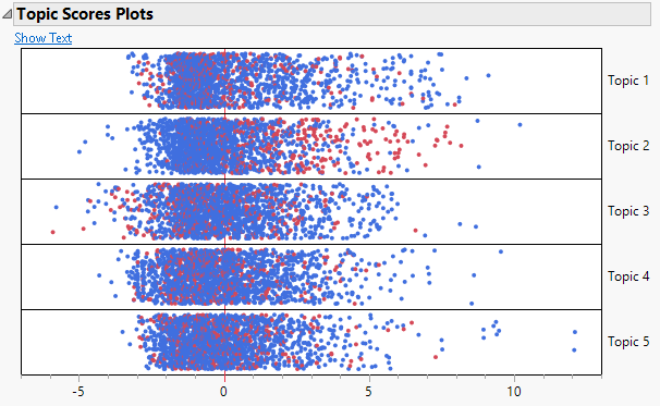

18. Image shown hereClick the gray disclosure icon next to Topic Scores Plots.
Figure 12.17 Topic Scores Plots for Narrative Cause
Each topic score plot contains a point for each document in the corpus. You can select points in these plots to further examine the text of specific documents.
You want to further explore the subject matter of Topic 2.
19. Image shown hereSelect the three right-most points in the Topic 2 plot and click the Show Text button at the top left of the graph.
The text of the three documents with the highest scores in Topic 2 appear in a new window. From these, you can confirm that Topic 2 relates to low altitude.
