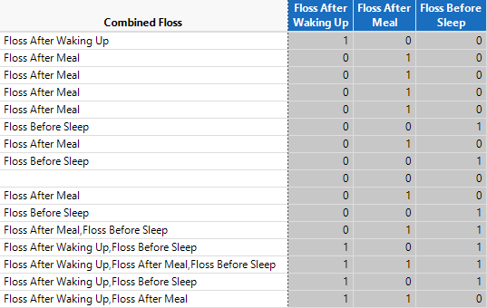

Figure 4.38 Combined Floss Column
The selected columns are represented in the Combined Floss column, and each field is separated by a comma. Only the columns that have a value of 1 are represented in the combined column for each given row.
