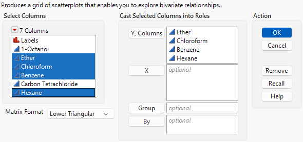

2. Select Graph > Scatterplot Matrix.
3. Select Ether, Chloroform, Benzene, and Hexane, and click Y, Columns.
Figure 4.15 Scatterplot Matrix Window
4. Click OK.

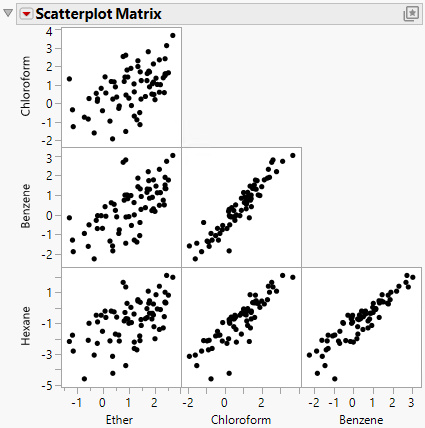

Figure 4.16 Scatterplot Matrix
Scatterplot Matrix
Interpret the Scatterplot Matrix
The scatterplot matrix provides these answers:
All six pairs of variables are positively correlated.
As one variable increases, the other variable also increases.
The strongest relationship appears to be between Benzene and Chloroform.
The data points in the scatterplot for Benzene and Chloroform are the most tightly clustered along an imaginary line.

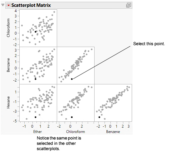

Interact with the Scatterplot Matrix
If you select a point in one scatterplot, it is selected in all the other scatterplots.
For example, if you select a point in the Benzene versus Chloroform scatterplot, the same point is selected in the other five plots.
Figure 4.17 Selected Points
Selected Points
