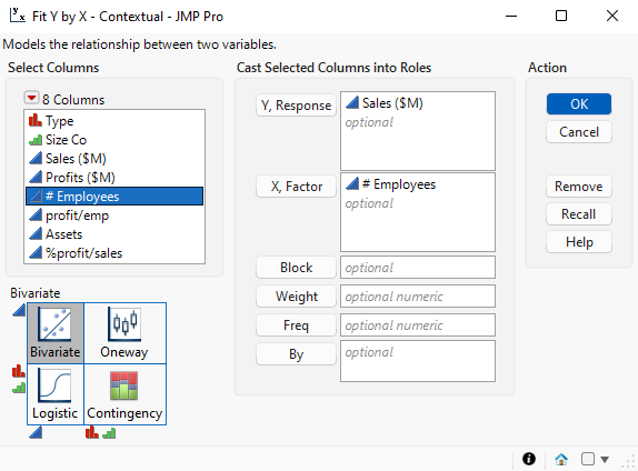

Create the Scatterplot
1. Select Help > Sample Data Folder and open Companies.jmp.
3. Select Sales ($M) and click Y, Response.
4. Select # Employees and click X, Factor.
Figure 4.10 Fit Y by X Window
Fit Y by X Window
5. Click OK.

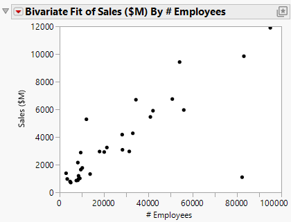

Figure 4.11 Scatterplot of Sales ($M) versus # Employees
Interpret the Scatterplot
One company has a large number of employees and high sales, represented by the single point at the upper right of the plot. The distance between this data point and all the rest makes it difficult to visualize the relationship between the rest of the companies. Remove the point from the plot and re-create the plot by following these steps:

The updated scatterplot provides these answers:
There is a relationship between the sales and the number of employees.
The data points have a discernible pattern. They are not scattered randomly throughout the graph. You could draw a diagonal line that would be near most of the data points.
Sales do increase with the number of employees, and the relationship is linear.
If you drew a diagonal line, it would slope from the lower left to the upper right. This slope shows that as the number of employees increases (left to right on the horizontal axis), sales also increase (bottom to top on the vertical axis). A straight line would be near most of the data points, indicating a linear relationship. If you have to curve your line to be near the data points, there is still a relationship (because of the pattern of the points). However, that relationship is not linear.
You can predict average sales from the number of employees.
The scatterplot shows that sales generally increase as the number of employees increases. You could predict the sales for a company if you knew only the number of employees of that company. Your prediction would be on that imaginary line. It would not be exact, but it would approximate the real sales.

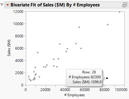

As with other JMP graphics, the scatterplot is interactive. Use your mouse to hover over the point in the lower right to reveal the row number and the x and y values.
Figure 4.13 Hover Over a Point
Hover Over a Point
Click a point to highlight the corresponding row in the data table. Select multiple points by doing one of the following actions:
Click and drag with the pointer to select points in a rectangular area.
Select the lasso tool and then click and drag around multiple points. The lasso tool selects an irregularly shaped area.
