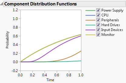

Image shown hereComponent Distribution Functions
Select Show Component Distribution Functions to show an overlay plot of the distribution functions for the components of the Reliability Block Diagram.
Figure 13.22 Component Distribution Functions

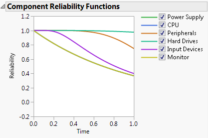

Image shown hereComponent Reliability Functions
Select Show Component Reliability Functions to show an overlay plot of the reliability functions for the components of the Reliability Block Diagram.
Figure 13.23 Component Reliability Functions

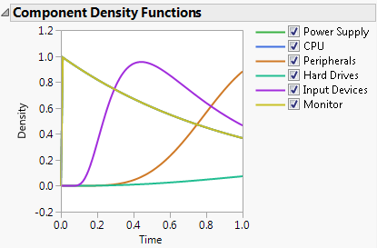

Image shown hereComponent Density Functions
Select Show Component Density Functions to show an overlay plot of the density functions for the components of the Reliability Block Diagram.
Figure 13.24 Component Density Functions

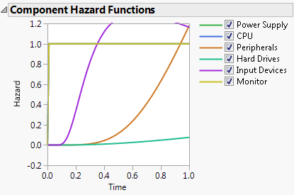

Image shown hereComponent Hazard Functions
Select Show Component Hazard Functions to show an overlay plot of the hazard functions for the components of the Reliability Block Diagram.
Figure 13.25 Component Hazard Functions

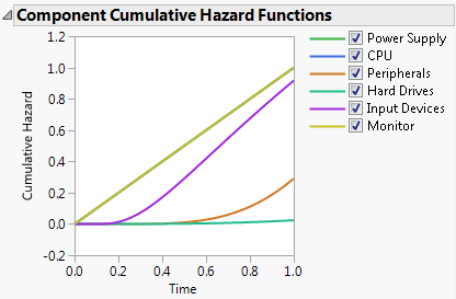

Image shown hereComponent Cumulative Hazard Functions
Select Show Component Cumulative Hazard Functions to show an overlay plot of the cumulative hazard functions for the components of the Reliability Block Diagram.
Figure 13.26 Component Cumulative Hazard Functions
