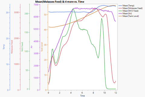

Figure 3.16 Multiple Y Axes
Multiple Y Axes
Axes for Temp, Molasses Feed, NH3 Feed, Air, and Tank Level is added to the graph, and the axes automatically rescale to display all values.
