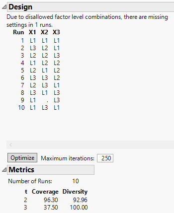

10. Click Make Design.
Figure 20.10 Design and Metrics
Design and Metrics
A note beneath the Design section indicates that one run has a missing setting due to the constraints. That run is run 9. To ensure that the covering array has strength 2, the combination of X1 set to L1 and X3 set to L3 is required. But for these settings, the constraints prohibit all settings for X2.
