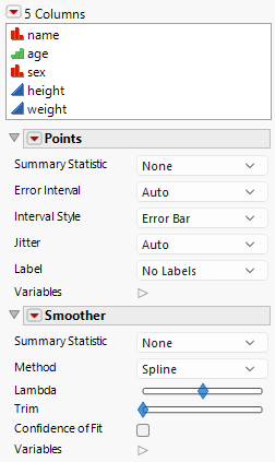

For each element that you add to a graph, an outline appears in the Properties area at the left side of the graph. This area is where you specify and change properties for each element type.
Figure 3.24 Properties Areas for Points and Smoother

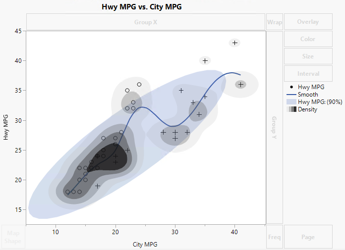

Select Multiple Elements at Once
To select and overlay multiple elements, press Shift and click the elements. Alternatively, you can drag the elements into the graph one at a time.
Figure 3.25 Graph That Shows Points, Smoother, Ellipse, and Contour Elements
