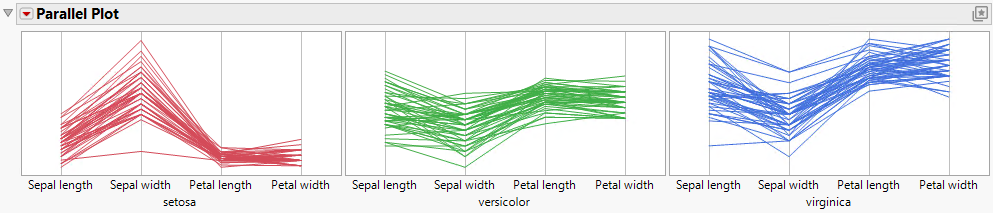

Examine Three Species in Different Parallel Plots
1. From the Iris.jmp sample data table, select Graph > Parallel Plot.
2. Select Sepal length, Sepal width, Petal length, and Petal width and click Y, Response.
3. Select Species and click X, Grouping.
4. Click OK.
The report window appears.
Figure 7.11 Three Species in Different Parallel Plots
Each species is represented in a separate parallel plot.
