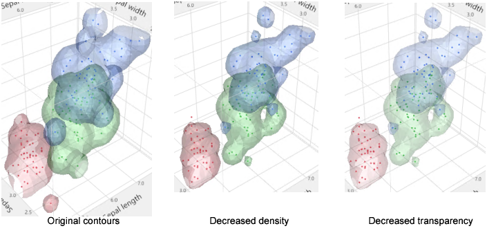

8. Type 0.25 in the first Contour Quantile box.
Twenty-five percent of the data points appear outside the contour surfaces, which results in smaller contours.
9. Type 0.15 in the first Transparency box.
The contours are 15% opaque.
Figure 9.10 Changing the Nonparametric Density Contour Transparency and Density

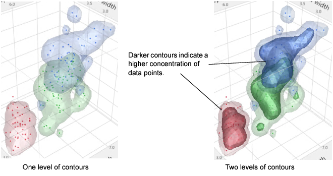

10. Select the second check box.
The contour quantiles are the same (.25), so the new contours overlap the first ones.
11. Type 0.5 in the second Contour Quantile box.
Fifty percent of the data points appear outside the contour surfaces. A second set of contours appears within the first to further illustrate the density of the data points.
Figure 9.11 Adding a Second Nonparametric Density Contour
