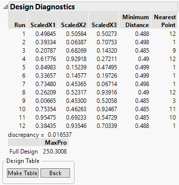

Figure 21.13 Design Diagnostics for Minimum Potential Design
6. Click Make Table.

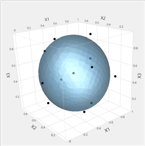

Visualize the Minimum Potential Design
You can see the spherical symmetry of the Minimum Potential design using the Scatterplot 3D graphics platform.
1. After you make the JMP design table, select Graph > Scatterplot 3D.
2. Select X1, X2, and X3 and click Y, Columns.
3. Click OK to see the initial three-dimensional scatterplot of the design points.
4. Click the Scatterplot 3D red triangle and select Normal Contour Ellipsoids.
5. Right-click the plot and select Settings.
6. Use the Marker Size slider to increase the marker size.
Figure 21.14 Minimum Potential Design Points on Sphere
Now the even spread of the points on the surface of the ellipsoid can be visualized.
