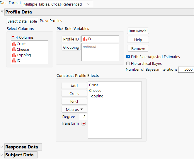

4. Click Select Data Table under Profile Data.
A Profile Data Table window appears, which prompts you to specify the data table for the profile data.
5. Select Pizza Profiles and click OK.
6. Select ID and click Profile ID.
7. Select Crust, Cheese, and Topping and click Add.
Figure 4.5 Profile Data

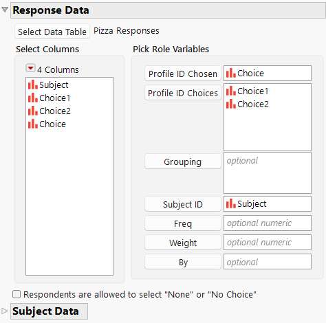

8. Click the disclosure icon next to Response Data to open the outline and click Select Data Table.
9. Select Pizza Responses and click OK.
10. Enter Profile ID selections as follows:
Select Choice and click Profile ID Chosen.
Select Choice1 and Choice2 and click Profile ID Choices.
Select Subject and select Subject ID.
Figure 4.6 Response Data Window
Choice1 and Choice2 are the profiles presented to a subject in each of four choice sets. The Choice column contains the chosen preference between Choice1 and Choice2.

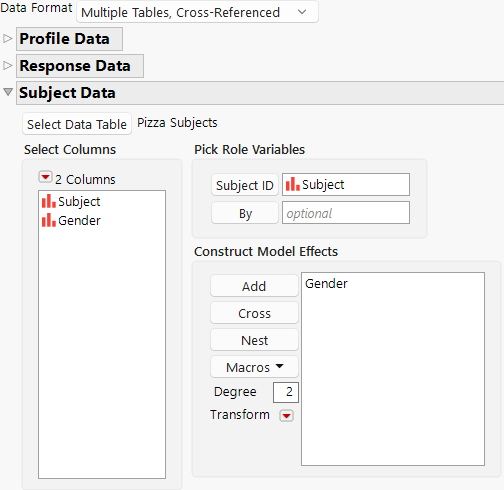

11. Click the disclosure icon next to Subject Data to open the outline and click Select Data Table.
12. Select Pizza Subjects and click OK.
13. Select Subject and click Subject ID.
14. Select Gender and click Add.
Figure 4.7 Subject Data Window
Subject Data Window

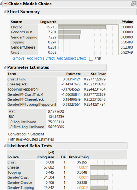

15. Click Run Model.
Figure 4.8 Choice Model Results
Six effects are entered into the model. The effects Crust, Cheese, and Topping are product attributes. The interaction effects, Gender*Crust, Gender*Cheese, and Gender*Topping are subject-effect interactions with the attributes. These interaction effects enable you to construct products that meet market-segment preferences.
Note: For Choice models, subject effects cannot be entered as main effects. They appear only as interaction terms.
The Effect Summary and Likelihood Ratio Tests reports show strong interactions between Gender and Crust and between Gender and Topping. Notice that the main effects of Crust and Topping are not significant. If you had not included subject-level effects, you might have overlooked important information relative to market segmentation.

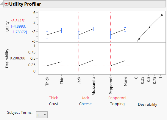

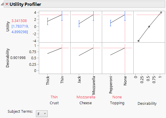

1. Click the Choice Model: Choice red triangle and select Utility Profiler.
The Subject Terms menu beneath the profiler indicates that it is showing results for females.
2. Click the Utility Profiler red triangle and select Optimization and Desirability > Desirability Functions.
Figure 4.9 Utility Profiler with Desirability Function
A desirability function that maximizes utility is added to the profiler. See “Profiler” in Profilers.
3. Click the Utility Profiler red triangle and select Optimization and Desirability > Maximize Desirability.
Figure 4.10 Utility Profiler with Optimal Settings for Females
The optimal settings for females are a thin crust, Mozzarella cheese, and no topping.

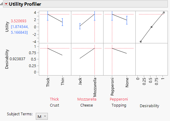

4. From the Subject Terms menu, select M.
5. Click the Utility Profiler red triangle and select Optimization and Desirability > Maximize Desirability.
Figure 4.11 Utility Profiler with Male Level Factor Setting
The optimal settings for males are a thick crust, Mozzarella cheese, and a Pepperoni topping.
