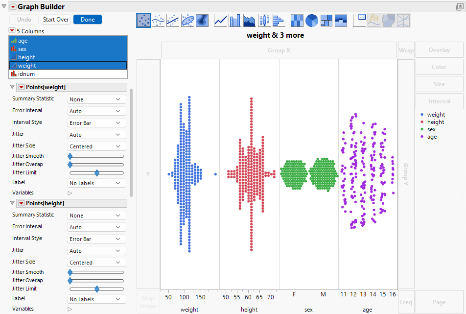

3. Select age, sex, height, and weight, press Shift, and click the X zone.
Figure 6.4 Adding Variables to the X Zone

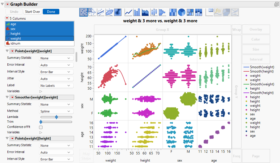

4. Select age, sex, height, and weight, press Shift, and click the Y zone.
Figure 6.5 Adding Variables to the Y Zone
5. Click the shaded area on the Smoother element Image shown here to deselect it.
6. Right-click the Legend and select Hide Legend.
7. Right-click the diagonal panels and select Points > Remove.

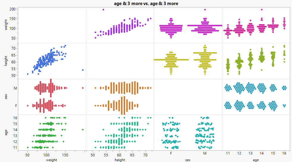

8. Click Done.
Figure 6.6 Scatterplot Matrix in Graph Builder
