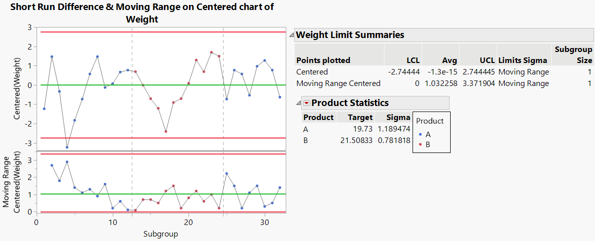

Figure 3.24 Short Run Control Chart
A Short Run Difference chart and Moving Range chart on the centered data are shown. The data points are colored by the product. There are dividers on the chart to show when production changed products. There is also a Product Statistics report that contains the target and sigma values for each product. The sigma value for Product A is 1.19 and the sigma value for Product B is 0.78. The sigma values do not differ by a large amount, so we can appropriately interpret the Short Run control chart. If the sigma values differed by a large amount, then a standardized chart could be considered. Product A had one point beyond the lower limit during the first run of that product.
