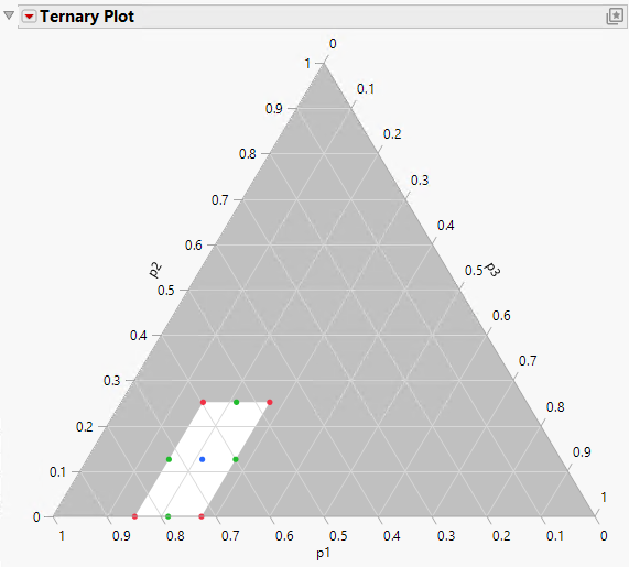

1. Select Help > Sample Data Folder and open Plasticizer.jmp.
The p1, p2, and p3 columns all have Mixture Column Properties defined.
2. From the Graph menu, select Ternary Plot.
Notice that p1, p2, and p3 appear next to X, Plotting.
3. Click OK.
Figure 11.7 Mixture Constraints in a Ternary Plot
