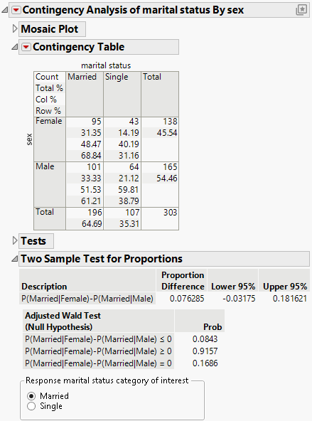

Figure 7.14 Example of the Two Sample Test for Proportions Report
In this example, you are comparing the probability of being married between females and males. See the Row% in the Contingency Table to obtain the following:
P(Married|Female) = 0.6884
P(Married|Male) = 0.6121
The difference between these two numbers, 0.0763, is the Proportion Difference shown in the report. The two-sided confidence interval is [-0.03175, 0.181621]. The p-value by the adjusted Wald method corresponding to the confidence interval is 0.1686, which is close to the p-value (0.1665) by Pearson’s chi-square test. The Pearson’s chi-square test is more common than the modified Wald’s test for testing the difference of two proportions.
