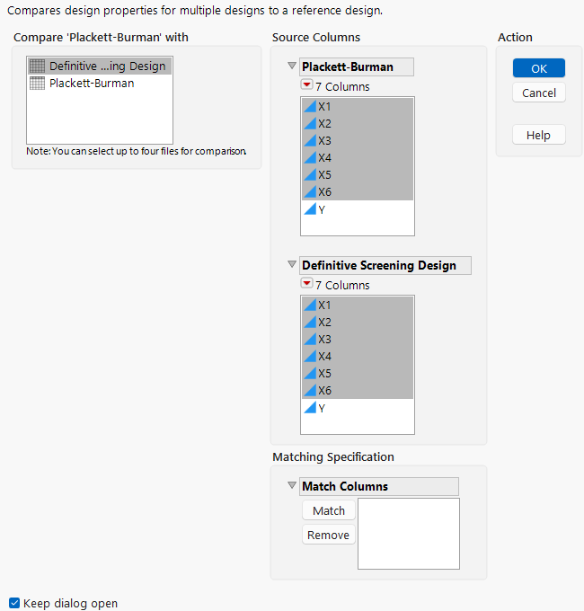

3. In the Plackett-Burman data table, select DOE > Design Diagnostics > Compare Designs.
4. Select Definitive Screening Design from the Compare ‘Plackett-Burman’ with list.
5. Select X1 through X6 in the Plackett-Burman panel and in the Definitive Screening Design panel.
6. Open the Match Columns section and click Match.
Figure 17.2 Launch Window with Matched Columns
This defines the correspondence between the factors in your two designs.
7. Click OK.

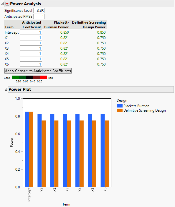

Figure 17.3 Power Analysis for PB and DSD Comparison
The Power Analysis report with the default settings for the significance level, Anticipated RMSE, and coefficients shows that for main effect tests, the PB design has higher power than the DSD.

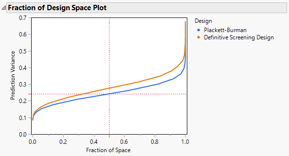

Figure 17.4 Fraction of Design Space Plot for PB and DSD Comparison
The Fraction of Design Space plot indicates that the PB design has smaller prediction variance than the DSD over the entire design space.
You conclude that, if you suspect that only main effects are active, the PB design is preferable.

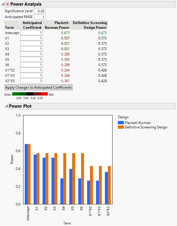

The Power Analysis report updates to include the added interactions.
Figure 17.6 Power Analysis for PB and DSD Comparison with Interactions
The Term list shows the three two-way interactions. If these two-way interactions are active, then the DSD has better performance in terms of power across all effects than the PB.

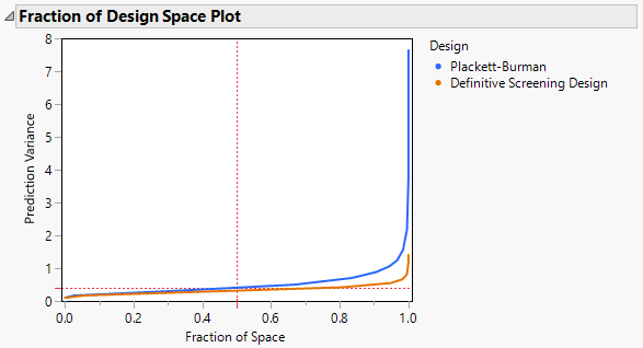

Figure 17.7 Prediction Variance for PB and DSD Comparison with Interactions
The DSD also outperforms the PB design in terms of prediction variance with the three interactions in the model. You can explore the other reports to see that the DSD is preferred over the PB design when there are potentially active interactions.
