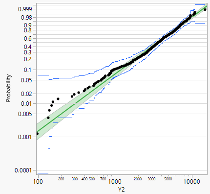

5. In the Compare Distributions report, select Weibull distribution and the corresponding Scale radio button.
A probability plot for a single Weibull distribution fit appears. Note that the fit is not very good in the lower part of the range of Y2.
Figure 3.23 Weibull Distribution FitĀ

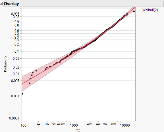

The probability plot for the Weibull(2) distribution fit appears. Note that the mixture of two Weibull distributions helps better capture the distribution in the lower part of the range of Y2.
Figure 3.24 Weibull(2) Competing Risk Mixture Distribution FitĀ
