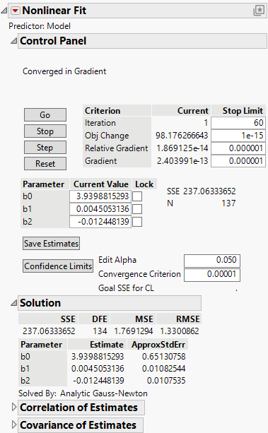

5. Click Go.
Figure 15.24 Initial Parameter Values in the Nonlinear Fit Control Panel
The report computes the least squares parameter estimates for this model.
6. Click Save Estimates.
The parameter estimates in the column formulas are set to those estimated by this initial nonlinear fitting process.

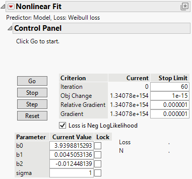

Figure 15.25 Initial Nonlinear Fit Control Panel
There is now the additional parameter called sigma in the loss function. Because it is in the denominator of a fraction, a starting value of 1 is reasonable for sigma. When using any loss function other than the default, the Loss is Neg LogLikelihood box on the Control Panel is checked by default.

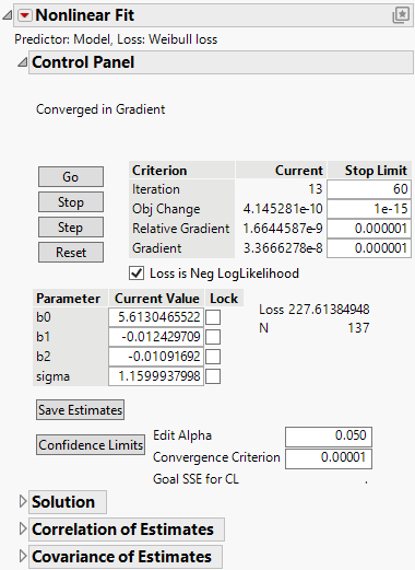

11. Click Go.
Figure 15.26 Nonlinear Fit
Nonlinear Fit
The fitting process estimates the parameters by maximizing the negative log of the Weibull likelihood function.

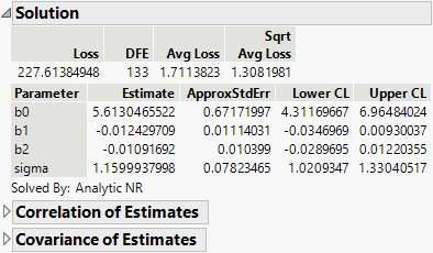

12. (Optional) Click Confidence Limits to show lower and upper 95% confidence limits for the parameters in the Solution table.
Figure 15.27 Solution Report
Solution Report
Note: Because the confidence limits are profile likelihood confidence intervals instead of the standard asymptotic confidence intervals, they can take time to compute.
