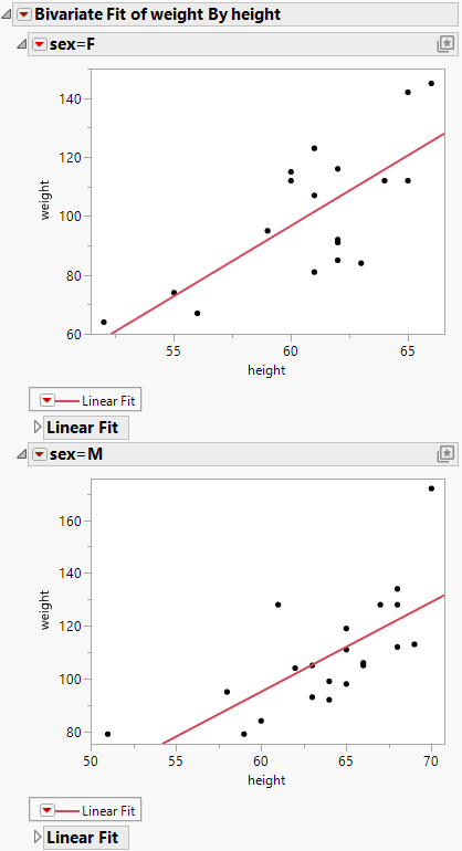

7. Press Ctrl, click the Bivariate Fit red triangle and select Fit Line.
Figure 5.21 Example of By Variable PlotsĀ
There are separate analyses for each level of the By variable (sex). You see a scatterplot for the females and a scatterplot for the males.
