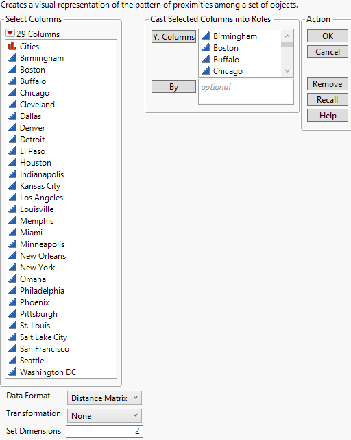

1. Select Help > Sample Data Folder and open Flight Distances.jmp.
2. Select Analyze > Multivariate Methods > Multidimensional Scaling.
3. Select Birmingham through Washington DC and click Y, Columns.
4. Select Distance Matrix from the Data Format menu.
Figure 10.2 Completed Multidimensional Scaling Launch Window
5. Click OK.

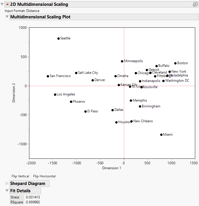

10. Select the Multidimensional Scaling Plot.
11. Click the Flip Horizontal button.
The Flip Vertical and Flip Horizontal buttons enable you to change the orientation of the MDS Plot. The MDS results are invariant to orientation. When the results have a known orientation, such as physical locations on a map, then you might want to rotate or flip your plot.
Figure 10.3 Multidimensional Scaling Plot
