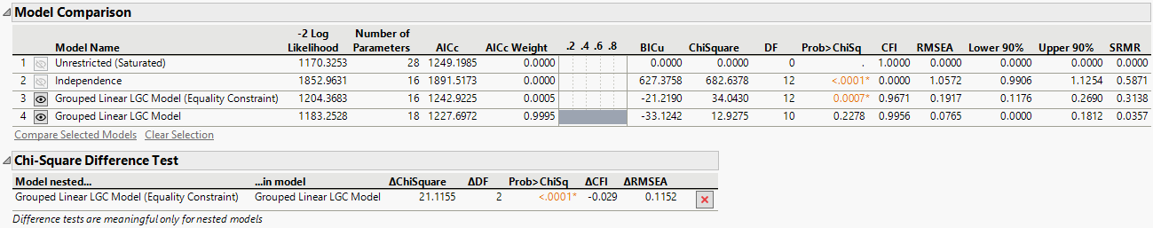

16. In the Model Comparison table, select both grouped LGC models and click Compare Selected Models.
Figure 8.20 Model Comparison Report
The chi-square difference test suggests that the equality constraints result in a statistically significant increase of model misfit and are thus not appropriate. Relatedly, the BICu values for both grouped LGC models are negative, which indicate that both models are favorable to the unrestricted model. You choose to continue with the unconstrained grouped LGC model since it is supported by the chi-square difference test and has a smaller BICu value.

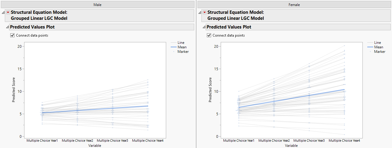

20. Select the Predicted Values Plot option.
21. Click OK.
Note: Selections in the Structural Equation Model: Grouped Linear LGC Model red triangle menu are applied to both the Male and Female tab reports.
22. Right-click on either the Male or Female tab and select Set Style > Horizontal Spread.
23. Select the Connect data points box.
Figure 8.21 Predicted Values Plots
The predicted values for males have a flatter slope and less variation than do the predicted values for the females over the 4 years.
