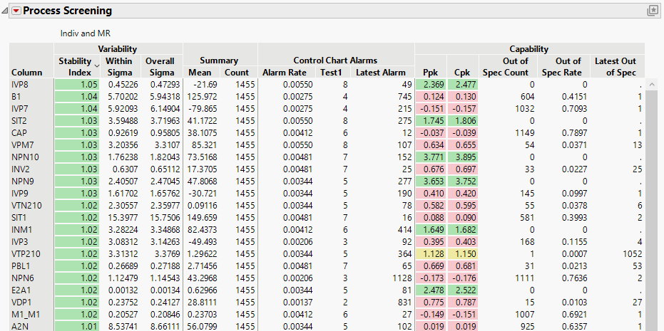

Figure 8.2 Partial View of Initial Report
The Process Screening window appears, showing a table of results for each process. The table is sorted by Stability Index. This is a measure of the stability of a process, where a stable process has a stability index near 1. Higher values of the stability index indicate a less stable process. (The sorting is indicated by the caret beside Stability Index in the report.) You want to take a closer look at processes with a stability index value greater than or equal to 1.03.

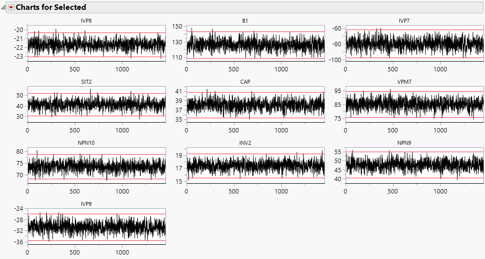

Figure 8.3 Charts for Highest Alarm Rate Processes
You decide to take a closer look at IVP8 (row 1, column 1 in the Charts for Selected).

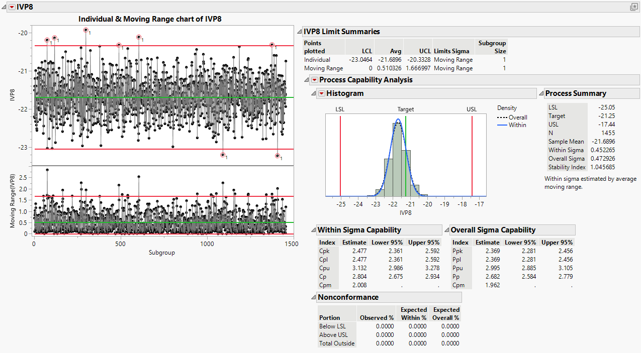

Figure 8.4 Control Chart Builder Report for IVP8
A Control Chart Builder report appears. Because IVP8 has a Spec Limits column property, the report also includes a capability analysis.
