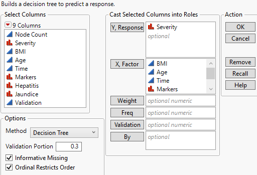

1. Select Help > Sample Data Folder and open Liver Cancer.jmp.
2. Select Analyze > Predictive Modeling > Partition.
3. Select Severity and click Y, Response.
4. Select BMI through Jaundice and click X, Factor.
5. Select a validation procedure based on your JMP installation.
For JMP Pro, select Validation and click Validation.
For JMP, enter 0.3 as the Validation Proportion.
Note: Results using the validation proportion can differ from those shown here, due to the random selection of validation rows.
Figure 4.17 Completed Launch Window with Validation Portion = 0.3
6. Click OK.

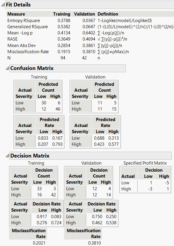

12. Click the red triangle next to Partition for Severity and select Show Fit Details.
Figure 4.19 Confusion Matrix and Decision Matrix Reports
The Confusion Matrix and Decision Matrix reports follow the list of Measures in the Fit Details report. Notice that the Confusion Matrix report and the confusion matrices in the Decision Matrix report show different counts. This is because the weighting in the profit matrix results in different decisions than do the predicted probabilities without weighting.
