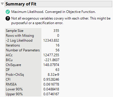

Figure 8.16 Summary of Fit for Summarized Data Format
The Structural Equation Models report that appears includes Summary of Fit and Parameter Estimates tables. The Summary of Fit table shows a good overall fit for the bi-factor model. The CFI value of 0.953 and RMSEA value of 0.062 both indicate that the model provides a reasonable approximation of the data.

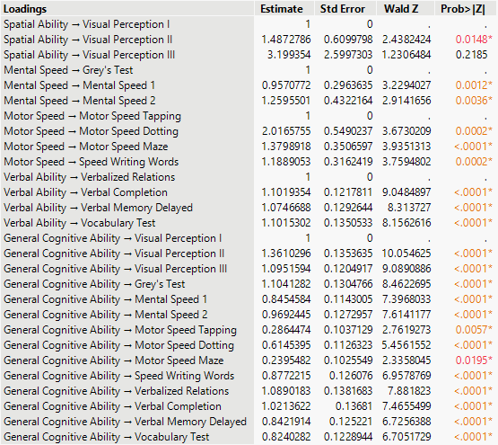

Figure 8.17 Parameter Estimates for Summarized Data Format
The unstandardized loadings shown in the Parameter Estimates report indicate that General Cognitive Ability significantly influences most of the observed variables across different cognitive domains. The specific factors (Spatial Ability, Mental Speed, Motor Speed, and Verbal Ability) also have significant influences on their respective indicators, though the strength of these relationships varies.
Tip: To view the standardized loadings, select the Standardized Parameter Estimates option in the red triangle menu next to Structural Equation Model: Model 1. Standardized loadings range from -1 to 1 and provide clarity on the strength of associations of indicators with their latent variables.

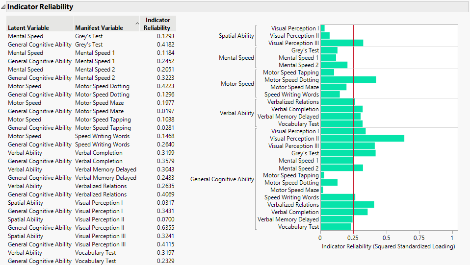

12. Click the red triangle next to Structural Equation Model: Model 1 and select Assess Measurement Model.
Figure 8.18 Indicator Reliability Report
The Indicator Reliability report shows reliability estimates for each indicator. These values are also represented in the bar chart and indicate that the General Cognitive Ability latent variable consistently explains a large portion of the variance in most of the cognitive ability tests. This suggests that it is a key factor that influences performance across different domains. Scores on the motor speed tasks are the only exception, which suggests that these tasks are not represented by the general factor. The specific latent variables Mental Speed, Motor Speed, Verbal Ability, and Spatial Ability show varying levels of indicator reliability, with some manifest variables (such as Motor Speed Dotting and Verbal Completion) that are better explained than others. Finally, low indicator reliability values for specific latent variables, such as those for the indicators of Mental Speed, suggest that some tasks are better indicators of general ability than their specific factors, such as Visual Perception I and Grey’s Test. Tasks like Motor Speed Tapping that have low reliability for the general and corresponding specific factor indicate potential measurement issues.

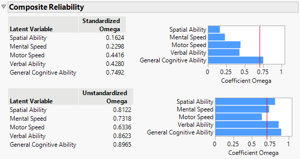

Figure 8.19 Composite Reliability Report
The Composite Reliability table contains Standardized and Unstandardized Omega (Hierarchical) values for different latent variables. The Hierarchical Omega values measure the reliability of the latent constructs in the context of a bi-factor model. The Hierarchical Omega indicates how well the latent variables (specific and general) in a bi-factor model account for the variance in the observed indicators. Omega values range from 0 to 1 and higher values indicate greater reliability.
Note: Standardized estimates are computed using the correlation matrix of the indicators and the standardized loadings, whereas unstandardized estimates use the covariance matrix and the unstandardized loadings. Standardized estimates apply to scores that are computed from standardized data, whereas unstandardized estimates are useful when scores are composite sums of the data in their original scale.
According to the standardized estimates, General Cognitive Ability (Omega = 0.7492) is the most reliable factor in this model, and it explains a large portion of the variance across all the indicators. Verbal Ability (Omega = 0.4280) and Motor Speed (Omega = 0.4416) are the most reliable specific factors, and they show the most explanatory power for their corresponding verbal and motor tasks. However, Spatial Ability and Mental Speed have lower Omega values, which indicate that they are less reliable in accounting for the variance in their respective indicators.
