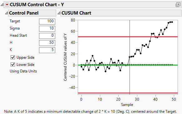

Note that the options below Head Start are H and K, instead of h and k. These parameters are now specified in units of the data column, rather than in standard deviation units.
Figure 10.6 CUSUM Control Chart ReportĀ
Like in the example using sigma units, the vertical line on the CUSUM Chart indicates that a shift in the temperature measurements started around sample 26.
