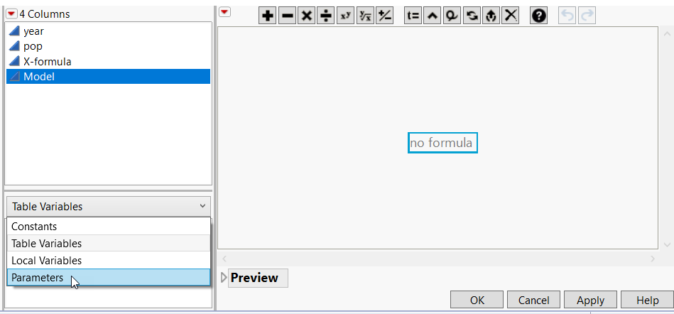

4. Select Parameters from the list below the list of columns.
Figure 15.2 Select Parameters
Select Parameters
