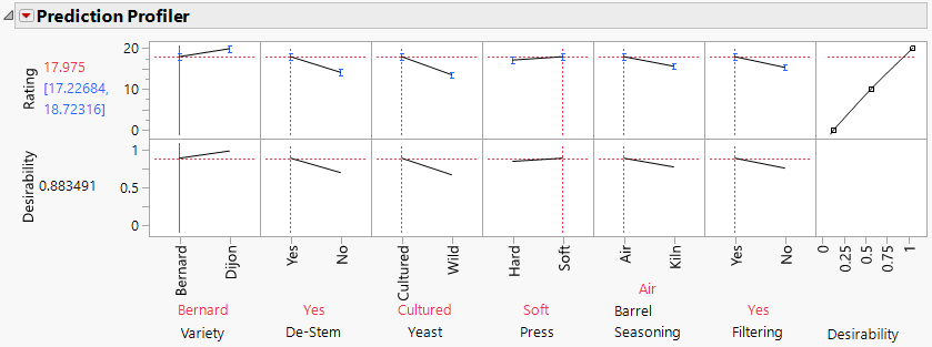

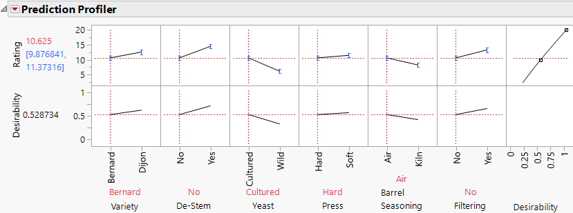

Figure A.29 Profiler with Original Value OrderĀ
Notice that the values for De-Stem and Filtering appear in the order No followed by Yes. You want to reverse these, so that the Yes level appears first.

Figure A.30 Profiler with New Value OrdersĀ
The levels for De-Stem and Filtering now appear in the order Yes followed by No.
