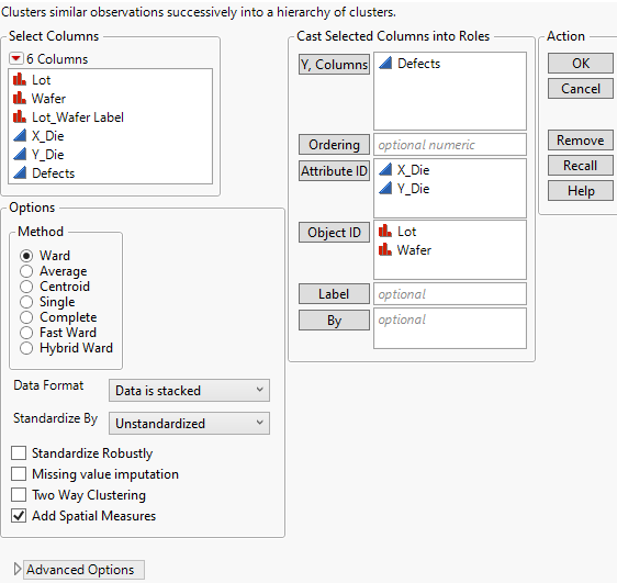

2. Select Analyze > Clustering > Hierarchical Cluster.
3. In the list next to Data Format, select Data is stacked.
Additional options for stacked data appear in the launch window.
4. Select Defects and click Y, Columns.
5. Select X_Die and Y_Die and click Attribute ID.
6. Select Lot and Wafer and click Object ID.
7. Select Add Spatial Measures.
Figure 13.7 Completed Clustering Launch Window
8. Click OK.

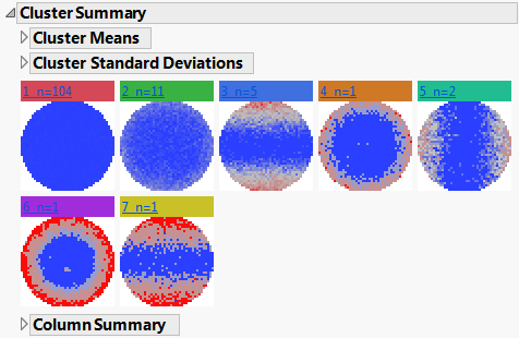

13. Click the Hierarchical Clustering red triangle and select Cluster Summary.
Figure 13.9 Cluster Summary Report
The wafer maps indicate the spatial nature of defects for each cluster. Cluster 1 contains 104 wafers with relatively few defects that are spread throughout the wafers. Cluster 3 has 5 wafers with defects concentrated at the extremes of the top and bottom hemispheres. You can view the maps for individual wafers and their Hough space maps in the data table produced by the cluster analysis. See Statistical Details for Spatial Measures.
