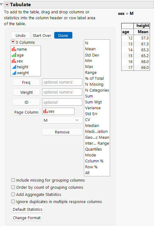

In this example, you have data containing height measurements for male and female students. Using the Tabulate platform, you want to create a table that shows the mean of the heights by the age of the students. Then you want to stratify your data by sex in different tables. To do so, add the stratification column as a page column, which builds the pages for each group.
1. Select Help > Sample Data Folder and open Big Class.jmp.
2. Select Analyze > Tabulate.
Since height is the variable that you are examining, you want it to appear at the top of the table.
3. Click height and drag it into the Drop zone for columns.
You want the statistics by age, and you want age to appear on the side.
4. Click age and drag it into the blank cell next to the number 2502.
5. Click Mean and drag it into the cell that says Sum.
6. Click sex and drag it into Page Column.
7. Select F from the Page Column list to show the mean of the heights for only females.
8. Select M from the Page Column list to show the mean of the heights for only males. You can also select None Selected to show all values.
Figure 9.23 Using a Page ColumnĀ
Using a Page Column
