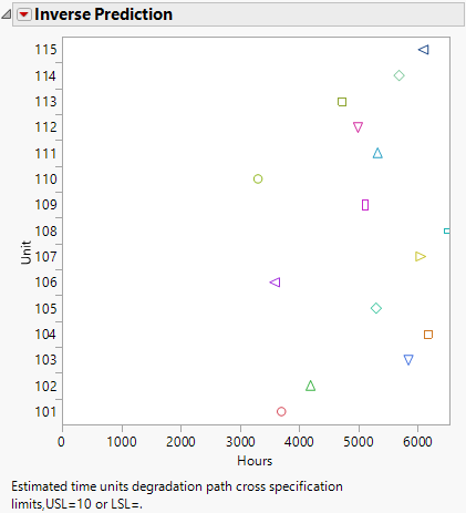

For the GaAs Laser example, enter 10 for the Upper Spec Limit and click Go. A plot is produced showing the estimated times until the units reach a 10% increase in operating current.
Figure 16.14 Inverse Prediction Plot
