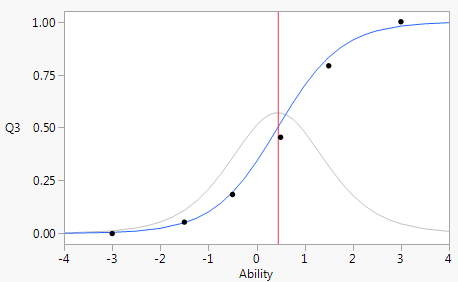

Figure 12.1 Item Analysis Characteristic Plot
