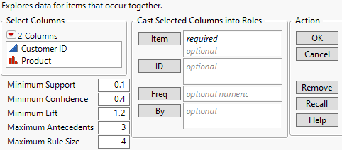

Launch the Association Analysis platform by selecting Analyze > Screening > Association Analysis.
Figure 27.4 Association Analysis Launch Window
