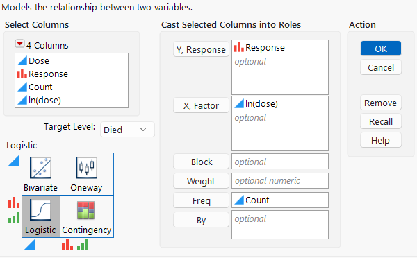

Launch the Logistic platform by selecting Analyze > Fit Y by X. The Fit Y by X launch window is used for four different types of analyses. When you enter an ordinal or nominal Y variable and a continuous X variable, the Logistic platform is launched.
Figure 8.3 The Logistic Launch Window
For more information about the options in the Select Columns red triangle menu, see “Column Filter Menu” in Using JMP. The Logistic launch window contains the following options:
