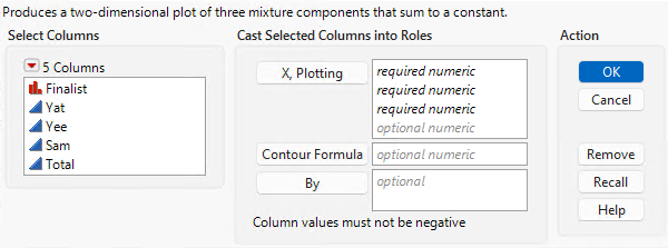

Launch the Ternary Plot platform by selecting Graph > Ternary Plot.
Figure 11.5 The Ternary Plot Launch Window
X, Plotting
Assign three columns to generate a ternary plot.
If you assign more than three variables to the X, Plotting role, a matrix of ternary plots is created. A separate variable is assigned to the first two axes of a plot, with the third axis being the sum of the other variables. If necessary, the variables are scaled so that they sum to 1.
Contour Formula
To plot contours of a response surface, assign a column that contains a formula to the Contour Formula role. If you have variables in a Contour formula that are not listed as X, Plotting variables, JMP appends sliders below the plot so that the values can be interactively adjusted. See Example of a Ternary Plot with a Contour Function.
By
Produces a separate graph for each level of the By variable.
After you click OK, the Ternary Plot window appears.
