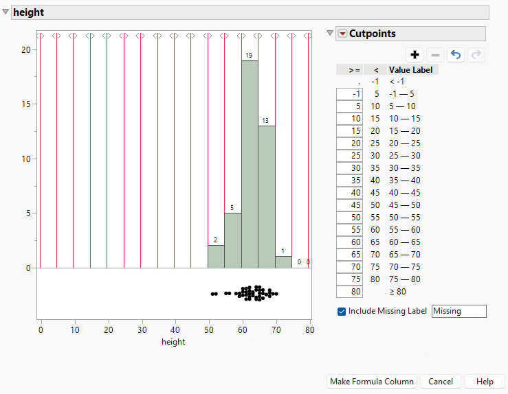

You can distribute your data into bins by using the Make Binning Formula option. Select the column or columns that you want to divide into bins, and select Cols > Utilities > Make Binning Formula. A histogram of the bins and a Value Label legend are shown, along with a red triangle that contains options for defining the cutpoints. There are several ways to add cutpoints, remove cutpoints, and adjust the bin sizes.
Right-click in the histogram to add or remove cutpoints.
Click and drag the vertical lines in the histogram to adjust the bin sizes.
Edit the boxes next to the cutpoint value labels to edit the cutpoint values and adjust the bin sizes.
Use the add Image shown here and remove Image shown here buttons above the Value Label legend to add and remove rows, which is equivalent to adding and removing cutpoints.
Use the undo Image shown here and redo Image shown here buttons to undo or redo actions done on the bin settings.

1. Select Help > Sample Data Folder and open Big Class.jmp.
2. Select the height column.
3. Select Cols > Utilities > Make Binning Formula.
You want the range of values to appear as XX, so in the Bin Label Style, keep the range set to LowHigh.
4. Click the Cutpoints red triangle and select Fill using Equal Width Bins.
5. In the window that appears, change the offset to -0.5.
Tip: For integer data, setting the offset to -0.5 helps disambiguate values on the edge. In this example, one of the bins covers 59.5 to 64.5, so it is clear that 59 and 65 are not included in this bin.
6. Keep the width set to 5.
7. Click OK.
8. Keep the Bin Label setting of Use Value Labels so that you can see the range of values for the bin.
Figure 4.41 Completed Binning Window
9. Click Make Formula Column.
A column called height Binned is added to the Big Class.jmp data table.
