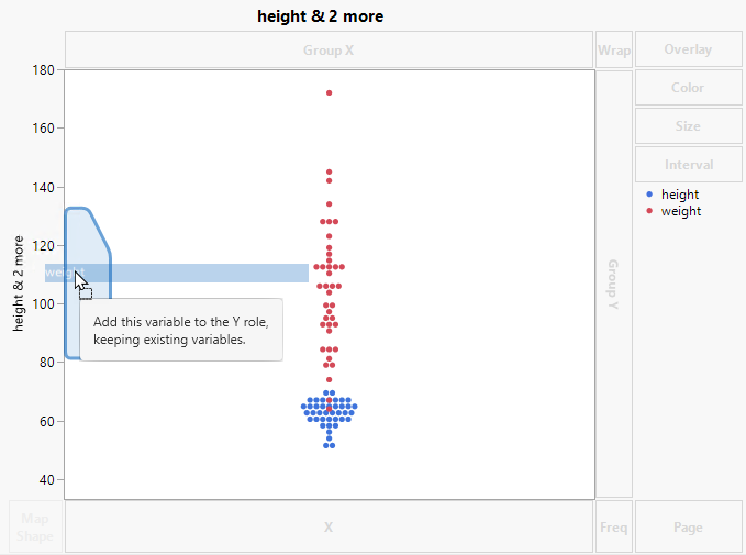

Merging variables places both variables on the same axis and creates a single graph for both variables. Elements in the plot are colored by the variables, and a legend appears to the right side of the plot. When points are plotted, they are randomly jittered for each value or category that is defined by the combination of the axes.
If you are starting with an empty zone, highlight multiple variables from the list and drag them into the zone at the same time.
If you already have variables in the zone and want to add more, drag the new variables to the inner side of the zone, in the graph area, until a symmetric polygonal shape appears.
Figure 3.11 New Variable Merged with Existing Variables
