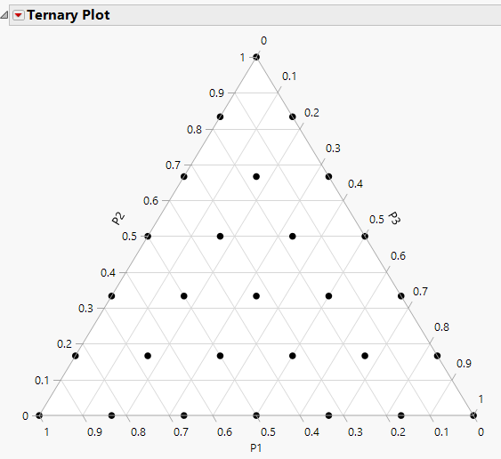

Because the mixture components are proportions that sum to one, the feasible region of a mixture design takes the form of a simplex. For example, a three factor deign can be visualized with a triangular two-dimensional graph and a four factor design can be visualized with a three-dimensional tetrahedron.
Figure 14.1 Ternary Plot
Ternary Plot
