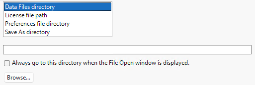

(Windows only) File Locations preferences set the default locations of JMP system files.
Figure 15.31 File Locations Preferences
Table 15.31 Preferences on the File Locations Page
Preference
Description
Data Files directory
Change the folder in which JMP looks for data files (for example, data tables).
License file path
Change the file path that JMP uses for your JMP License file.
Preferences file directory
Change the folder in which JMP looks for preference information.
Save As directory
Change the folder in which JMP saves data files when you select File > Save As.
Always go to this directory when the File Open window is displayed
Select to have JMP always use the specified path when you select File > Open.
