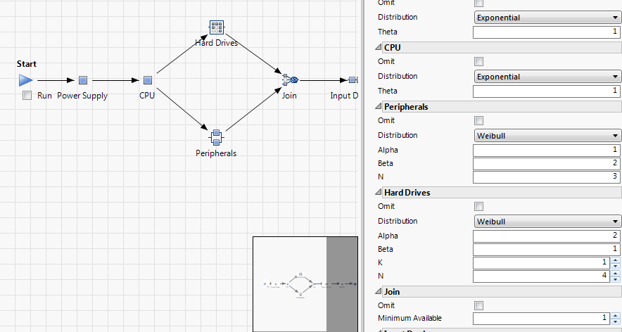

When the system diagram is too large to appear in the workspace, the Preview window in the Reliability Block Diagram platform enables you to reposition the portion of the system diagram that appears in the workspace. The viewing area is indicated in the Preview window by a white background. Drag the viewing area to reposition the view of the Workspace to another part of the system diagram.
Figure 13.11 Preview Window with Visible Part of Diagram on White Background
