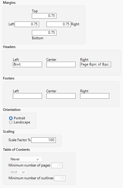

The Print preferences page enables you to configure default print settings such as margins, headers, and footers.
Figure 15.30 Print Preferences
Print Preferences
Table 15.30 Preferences on the Print Page
Preference
Description
Top (margin)
Sets the print page’s top margin. The default setting is 0.75 inches.
Left (margin)
Sets the print page’s left margin. The default setting is 0.75 inches.
Right (margin)
Sets the print page’s right margin. The default setting is 0.75 inches.
Bottom (margin)
Sets the print page’s bottom margin. The default setting is 0.75 inches.
Left (header)
Sets the page’s left-side header information. The default setting is &wt; (that is, the title).
Center (header)
Sets the page’s center header information. The default setting is blank.
Right (header)
Sets the page’s right-side header information. The default setting is Page &pn; of &pc; (that is, Page # of count).
Left (footer)
Sets the page’s left-side footer information. The default setting is blank.
Center (footer)
Sets the page’s center footer information. The default setting is blank.
Right (footer)
Sets the page’s right-side footer information. The default setting is blank.
Orientation
Sets the page’s print orientation as either Portrait or Landscape. The default setting is Portrait.
Scale Factor
Sets the page’s print scaling factor (in percent). The default setting is 100%.
Table of Contents
Specifies whether to print a Table of Contents of your chosen file. The default setting is Never.
When set to Conditionally, JMP determines whether to print a Table of Contents based on the values of the following options:
Minimum number of pages
And/Or
Minimum number of outlines
Note: The code for printing the current date in the header or footer is &d.
